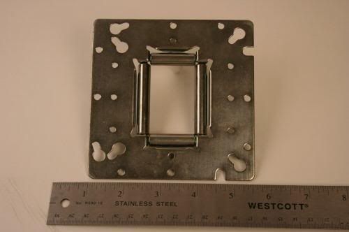

This is a cover plate with rollers, for one-man pulling. Anyone ever try something like this? Slick as snot.

I'm not familar with anything like that, but pretty neat. Cost?

About 20 bucks. As soon as I figure out or remember where it came from, I'll post that too.

Holy crow, that is cool!
Has about a bazillion holes to fit any box it looks like.
Do post the link Marc.

Just screws onto the front of the box, temporarily. The rollers guide the conductors into the conduit, and prevent hard snags. Pretty nice for guys who normally work by themselves.
Frank, do you use much conduit in the UK? or is everything mostly all cable wiring methods?

Now that's what I call clever! Snagging cable when drawing conduit cables is guaranteed. But this little gizmo is a great idea.
Conduit is used a great deal here Marc. We don't use the sort that you do though. The conduit is drawn steel. Heavy stuff and seamless. All ends are threaded into couplers or boxes or whatever. The use of the push and screw with a fixing screw type you have is not allowed. Used to be some years ago. Think the trade name was 'Fit-Fibo'.So if you cut a piece of conduit you have to re-thread the end about 1 inch so you can either add a piece or make off into some box. Black enamel painted is the most common but where wet or moist conditions prevail the a galvanised option can be used. Generally 3/4 " (20mm) or 1" (25mm) is the size most used.

Okay, got it figured out where you all can get these if you want them. You have to buy them in 10 packs, so if you don't want 10, you'll have to take orders from 9 buddies at work.

Looks like a great tool! I checked the website, and it looks like they have started selling them as singles now.
http://www.garvindirect.com/productD...oductID_E_315#
