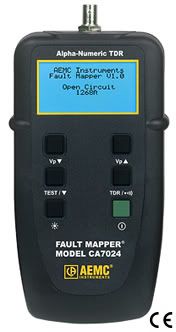

Just found this one actually, seems to fit my needs. For some reason yesterday google only gave me $8,000-$29,000 choices
AEMC CA7024 Fault Mapper Alpha Numeric TDR

No way! I have one of those and sure didn't pay that for it. I've found it to be confusing to use. Not sure of your exact use for it? I forget the technical reason right now but there is a built-in error. Meaning, say if you had a break in a lenght of romex inside a wall, you can't attach it directly to the conductors at the receptacle and get a accurate reading. You would have to attach a extension cord of similiar guage first and read through it also. IIRC, it must be over 7' long.
I think that you can download the manual from AEMC site. If you get that far I have copy of different types of junctions/breaks and how they look on a graphic screen. Well, at least how they are supposed to look!
Whoops! I have the CA-7026 or the graphing model.
Bill
Thanks, I realized i need the CA-7026 as I need to measure twisted pair as well. I found it for about $795

I have the Fluke ts-90 that works ok and can be found for around $200.00.

I ran CAT 5E and RG-8U(I believe) side by side for my ATT&T Uverse service hookup. As I remember they didn't jive with eachother either but maybe it's just me??

I have a couple that I am playing with:
Riser Bond 1150
http://www.radiodetection.com/doclib..._br2007_en.pdf
and
Bicotest T631
http://www.radiodetection.com/doclib...et_2007_en.pdf
The Riser Bond unit is a more basic one that shows up frequently on Ebay for reasonable money. Thats where I got both units. The Bicotest unit had to be sent to England for a new screen. I bought that one for the larger screen for better resolution. Did I need it, no, but I bought these to help find underground faults. So far having better luck with A frames. I need to find the values for UF and probably have better luck.

I've used this one before and really liked it.
http://www.flukenetworks.com/datacom...rbt-bridge-tap
If I recall correctly it's like $200.
