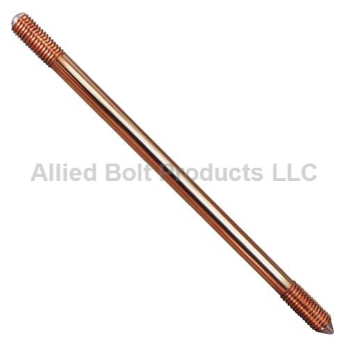

They make ground rods that are screwed together to make unlimited lengths. Called Sectional Ground Rods

Why would you weld ground grounds. I do not even think you can weld them, as least not cadwelding them.
I've driven 20-40' ground rods before and we have only used ground couplings.
