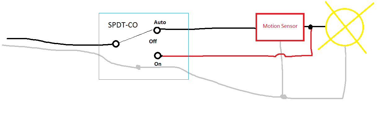

Thanks, now for the I am stupid part. What gives by energizing the load side of the motion switch? It does nothing cause the switch is NO?
Insert diode here? Get a cheap fixture and try it?
I love hearing about others experiments!
Ontariojer is offline   Reply With Quote
Old 04-29-2012, 07:11 PM   #22
Chief Electron Relocator
Posts: 31,280
If you energize the load side of the motion sensor, your light comes on.

I think he means will it f up the electronics, and i would say 'it depends' see my post above.

If you use an RAB Stealth (please do!), you can toggle the regular snap switch a certain number of fast toggles to have it on. Turn it off for off. Turn it back on for motion. Problem solved.

I'm unclear on why the 3 way idea doesn't work. Run the neutral and ground wire the standard way, feed hot to the common terminal,one wire connected to one traveler terminal goes to the sensor line input, and the other conductor connected to the remaining traveler terminal bypasses the sensor portion of the light and connects directly to the lamp wiring. When in the bypass sensor position, why the fried electronics in the sensor?
I never ran across such a setup , but it seems reasonable to me to use the three way switch..

You can absolutely feed the "other side of the sensor" to have the lamps on all the time. If someone said they fried the electronics, they were either mistaken or did something seriously wrong. I've done it many times.

I will check it again. You guys made me call the lady. She says it works dusk till dawn, but no motion. And it can be turned off and I suppose always on. Hmmm seems it does work, maybe I should trust myself more. A simple select on the motion detector and move the single pole make break to in front of the three way and I should be good to go. I like Kens way best tho. Maybe next time I will do like cletis and ask before i do the work.

A 3-way will not afford you the "Off" option unless you install a single-pole ahead of it. That, or use a SPDT-CO switch.

Exactly, there's no reason you couldn't. Replace the motion sensor with a photocell, it'd be the exact same thing. There's obviously other ways to do it, but feeding the 3 three way with a single pole to completely remove power, then just using the 3 way basically as a selector switch should work fine.

Feed the fixture with a 3 wire.
Make the black hot and the red switched.
Hot feeds the motion, switch leg feeds the switch leg (along with the wire from the motion module)
