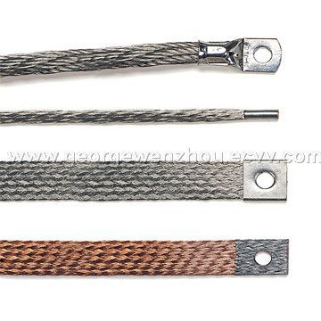

Old 03-22-2009, 09:29 AM   #7
brian john's Avatar
Join Date: Mar 2007
Location: Leesburg VA
Posts: 6,513
Originally Posted by 480sparky View Post
I also have never heard stapping used in this sense.
Some large generators have bus connections for changing the voltage, these bus look like straps hence the term strapping. The flexible conductors from the generator are permanently mounted on studs, relocating the straps permits quick changing of voltage, this is big in the rental business.

Old 03-22-2009, 09:55 AM   #9
Posts: 6,837
The one's I've dealt with are the flat braided conductors with heavy heat shrink over them. I know these aren't used on the very large gensets, but certainly on smaller one's.
Old 03-22-2009, 09:58 AM   #10
brian john's Avatar
Join Date: Mar 2007
Posts: 6,513
MArc during the 2001 dotcom bust, a rigger I know got stuck with 20 750-kw UPS's systems to recoup his losses he scrapped them. He had 100'00 of the flexible straps from 12" to 24" rated 500-1000 amps.
I took about 50 or 60 of them for connecting CB's to out high current test sets.
