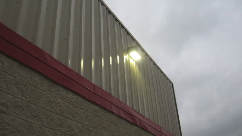

I asked about this awhile back . This is the system I used to hang around 900' of of those cheap ass 2 bulb fixtures. I didnt see anyway that was faster for the money. The cable cost 175.00 per 1000' the crimps, "I" bolts and turn buckle were another 75.00. i had just under 100 man hours in the 1st store and 80 in the last one.
Pick it apart guys, I have 10 stores in the next 12 months and want the fastest way possible

They over engineered the hell out of this project. There are 12 rows of lights, they each pull around 3.5 amps. They have 24 circuits for those lights. They also used a bunch of LED wall packs that each have their own circuit, they are 70 watts each and there are 9 of them.
that's your typical retail odd lots setup. think about how much light is wasted upward and absorbed by that hideous ceiling. Also, they are going to be chasing bulbs forever which is a total waste. All those wasted circuits when they could of possibly done it on only several or so. Do they have 277V ?? those are probably crappy 3 phosphor rapid start cheap chinese electronic ballast too. Hideous. Almost want's to make me puke. They did a little better outside with the LED's but could have been better.
Your installation looks fine though...
