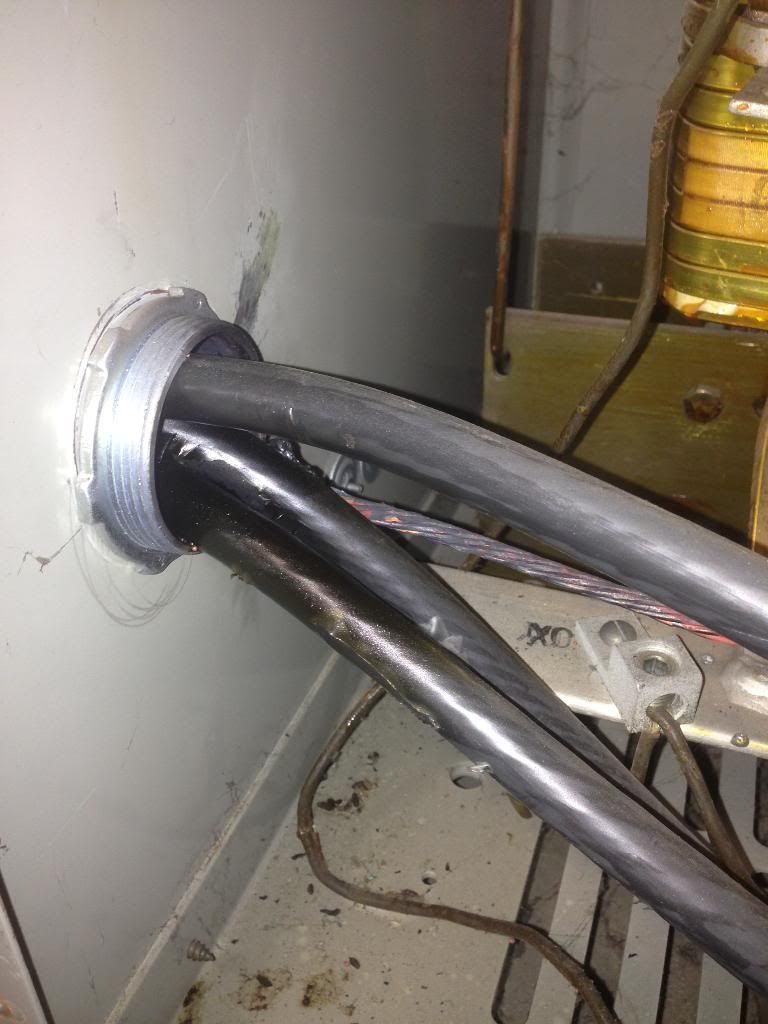

Looks like a grounding bushing to me.There was no bushing....:no::laughing:
Well,,,,Looks like a grounding bushing to me.
thats ok Harry, the post still counts :whistling2:Well,,,,
I need better glasses...:whistling2::laughing:
Maybe the plastic burned away.... or got knocked off/broken during installation and was never there.Well,,,,
Yeah!!:laughing:thats ok Harry, the post still counts :whistling2:![]()
It was.It would be more impressive if it was 277:whistling2:

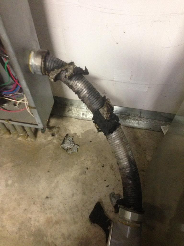

I have to say that it looks as though 480 volts was not involved...Not enough damage.

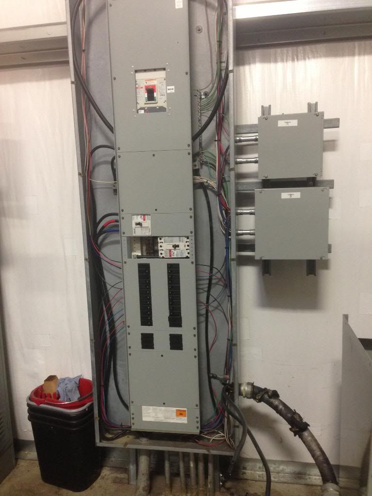

That's an interesting one. I see an EGC, so I assume the fault occurred inside the flex itself, and the connections were high enough impedance that the breaker took forever to clear it?
Prove it. I don't believe it at all. There is no evidence to prove anything has happened there at all.It was.
Fault happened at the other connector inside the panel that I didnt take a picture of. No bushing on that side either, insulation rubbed through and it was over. Happened at night when no one was in the warehouse not sure how long it took the breaker to clear but it did trip. Not till everything melted though.That's an interesting one. I see an EGC, so I assume the fault occurred inside the flex itself, and the connections were high enough impedance that the breaker took forever to clear it?
