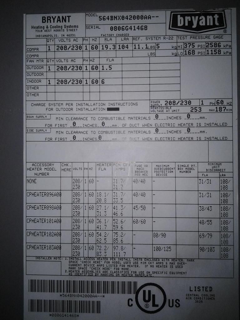

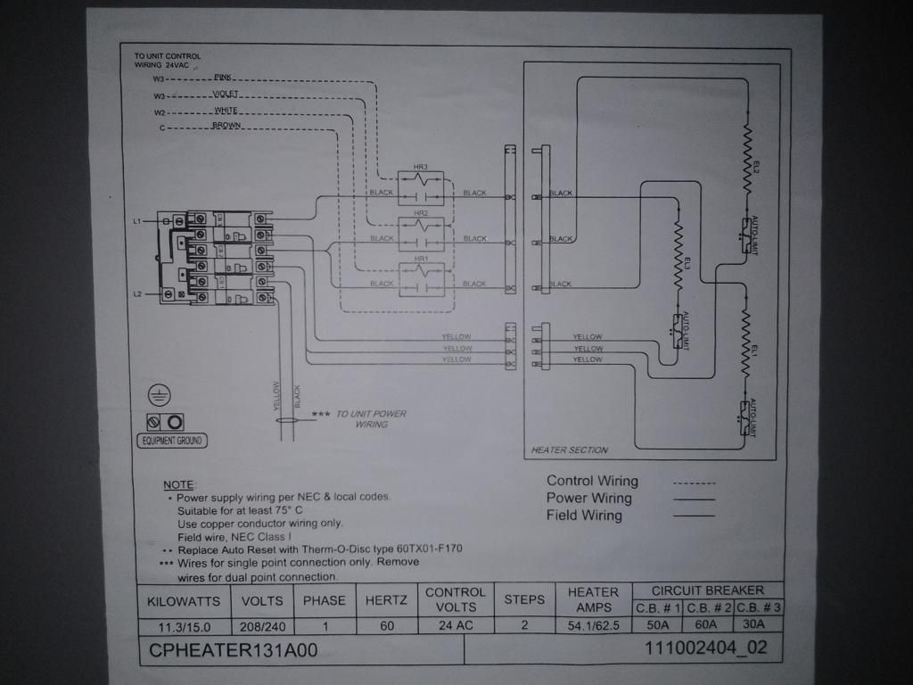

thanks. whoever put this in ran a #4 but put it on a 50a breaker, then installed a 30a fusible disconnect.Minimum conductor ampacity 85.6/ maximum ocpd 90 amps
That is not what I am seeing...I'm seeing MaxOCP at 80/90A depending on voltage for the heaters.According to the nameplate and the heater package installed, minimum circuit ampacity is 111.7 amps and maximum OCPD is 125 amps.

You're correct, the heater package above the one I listed corresponds to the amperage of his heater package.That is not what I am seeing...I'm seeing MaxOCP at 80/90A depending on voltage for the heaters.
15 kW element @ 62.5 fla + indoor fan @ 6 fla = 68.5 x 1.25 = 85.625Can someone please show me where the 85.6 comes from?
He is only running with the 15 kw heater.According to the nameplate and the heater package installed, minimum circuit ampacity is 111.7 amps and maximum OCPD is 125 amps.
