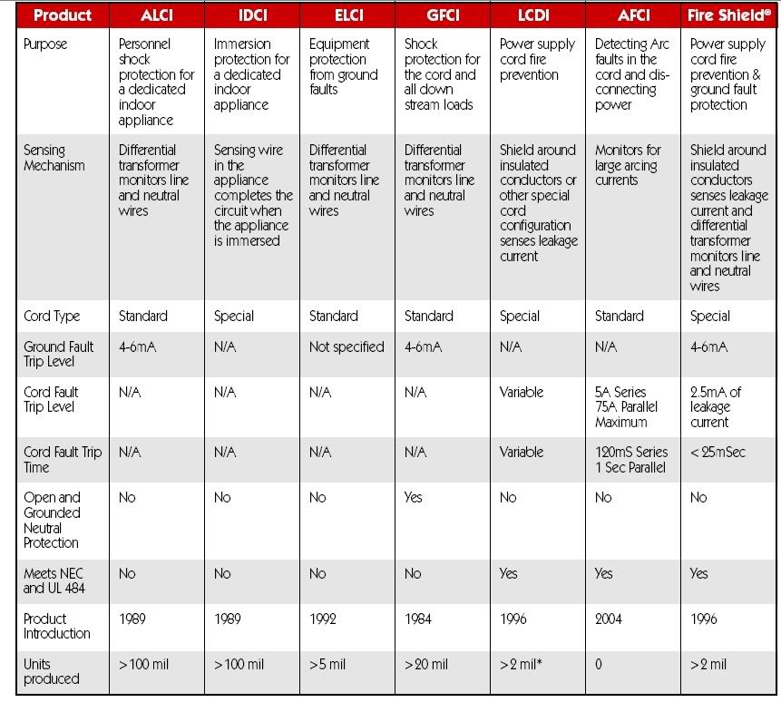

How does an LCDI differ from a GFCI? anyone know the characteristics differences?
I'd sorta like to know myself. I did try to look the other night to see what the trip point of an LCDI was, and couldn't come up with anything. What I did find was that most or all cord-end LCDI's are made by no-name manufacturer's in China, so a quality issue might be the main culprit on many of these mysterious tripping air conditioner LCDI's.
Hey, I just found this document, which is pretty interesting regarding LCDI's. http://www.fireshield.com/04_0301TechNotes.pdf
It seems LCDI cord ends use shielded cable for the cordset, and it's looking for leakage to the shield. The document includes this chart:
I'm curious enough now to maybe see if I can still get one of those little 89 dollar window air conditioners at WalMart and tear the cord and the LCDI apart.
