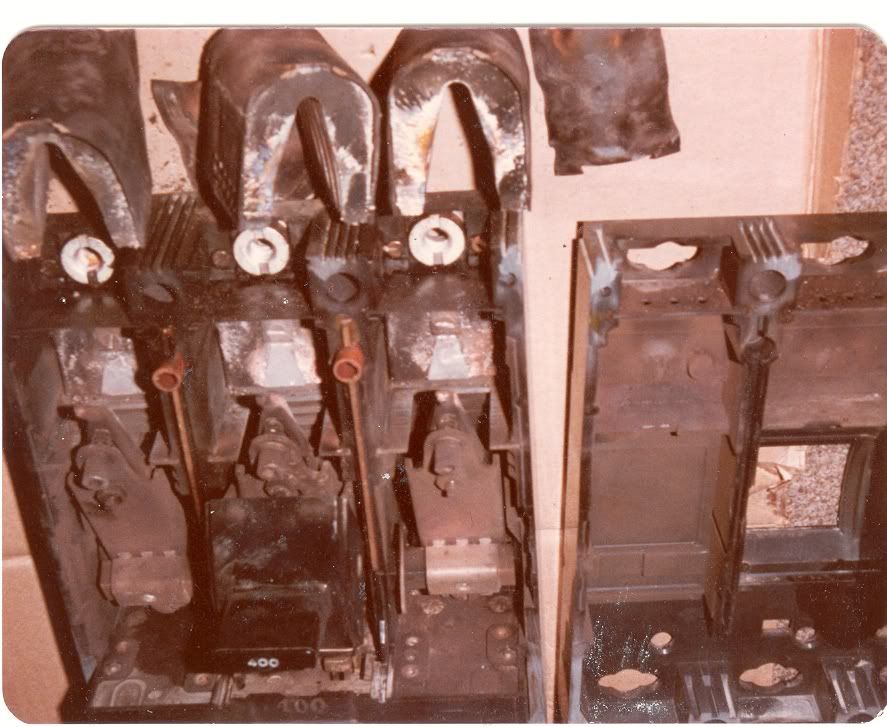

I will post the pictures and NEMA standards later.
Found one of the pictures
2nd attempt to close a circuit breaker into a fault, trip and extended stay at the hospital for this electrician
When you have a CB closed into a fault there is carbon and metallic debris from the arcing contacts eventually depending on the extent of previous faults this carbon and metallic deposits can result in a fault.
AT a minimum the circuit breaker should be meggered, phase to phase and pole to pole-line to load.

We say if there is a fault the CB should be at a minimum meggered phase to phase and pole to pole line to load. Additionally we like to ductor/micro ohm the CB and perform a visual inspection of the contacts if possible.

Agreed. UL 489 tests MCCBs to open and close three times into their full interrupting rating, after that, all bets are off.
That said, I still think it's a terrible idea. I've seen a single short circuit test blow pieces out of a breaker, and the factory rep argued that was "normal" just as long as the breaker was completely torn-down and repaired after each short-circuit fault. Well, yeah, but what are the odds of that happening? :rolleyes:
