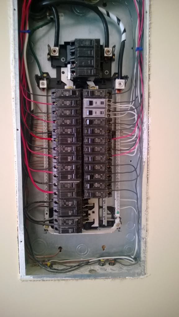

No, the service is on the outside wall.Is that a service?
I see a green screw....No, the service is on the outside wall.
Ataboy, weird colour code???
Why? This is the main panel. But the service is still on the outside wall.Remove the jumper between ground and neutral bus and pull the bonding screw out of the neutral bus and put it in the ground bus.
We mean main breaker/mbj ShockNo, the service is on the outside wall.
Can only be bonded at one place, the main serviceWhy? This is the main panel. But the service is still on the outside wall.
It takes a lot of ataboys to make up for an "Oh ****"Ataboy, weird colour code???
put some red tape on that main line
Let me rephrase. This is the main service disconnect. The actual service (Meter, and mast) are on the outside wall.Can only be bonded at one place, the main service
You're grounding the neutral at more than 1 pointWhy? This is the main panel. But the service is still on the outside wall.
Nevermind. I thought you meant you had a service disconnect on the outside wall.Why? This is the main panel. But the service is still on the outside wall.
Then its all wrong. Just quit doing electrical work.No, the service is on the outside wall.
Read 2 post above.Nevermind. I thought you meant you had a service disconnect on the outside wall.
If this is the first disconnect after the meter, you're alright.
The first disconnect is the meter.Let me rephrase. This is the main service disconnect. The actual service (Meter, and mast) are on the outside wall.
