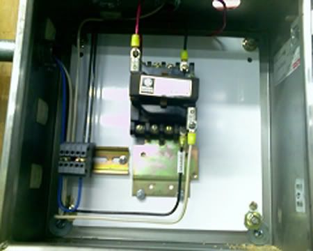

Here's a lighting contactor I installed yestersday in Flying Jay refinery.
I snapped it with my camera phone and posted it because I know everyone likes seeing pictures.
It's actually a motor starter with the overloads removed and the 480 coil changed to 120. The stainless hoffman box is also recycled.
Don't know why they're trying to skimp on stuff but I install what they give. I just hope this 'skimping' doesn't also reflect on safety stuff.:001_huh:
The blue is the feed, one b;ack runs the lights and the other runs the photocell which runs the coil. And the extra contacts are for future additions.

Looks great, Joe.
Nothing wrong with recycling stuff that the customer owns, as long as it's safe and compliant to do so. I find that many of my industrial customers do that. Stuff gets moved around in industry so often, you don't really have the luxury of using brand new stuff all the time. Your pic shows you can do nice work with old junk. The Professional Electrical Apparatus Recycler's League is a standards organization devoted to developing standards to help our industry reuse electrical material in a safe manner.
www.pearl1.org
Yeah, I took the starter apart to make sure it looked okay before I installed it(also to kill some time(refinery's paying by the hour and all with not much to do))
The holding contact (on the left) was completly broken off and the other contacts were so pitted I had to file on them for about 20 minutes. That's why I used the set on the right because it was in the best shape.
I like working in the refinery because materials are the highest quality and money is not a concern, though in this case I guess it was. Oh well I made it look as best a broken down motor starter used as a lighting contactor in a high dollar stainless stell hoffman box could, haha

Is this an add-on contactor? Is there a By-pass switch for maintenance purposes? I always install a by-pass switch. Nothing worse than climbing to the top of a roof to cover a photocell.
BTW Nice job wiring!
If you can find the photocell !
I like to write on the contactor j-box or some other obvious place where the photocell is. I spent the best part of an hour at a Denny's restaraunt trying to find a photocell once. Turned out, it was barely visible on an air conditioning unit.
We'll usually jumper out the contactor to get the lights to come, though it is easier to tape the photo cell if it's accessable.
Today I wedged a screwdriver in a GE lighting contactor to keep it on long enough for the lamps to warm up to take an amperage reading.

Looks great but what about the NRTL listing. Does your AHJ allow homemade products to be used?
He didn't make it in a blacksmith's shop, for Pete's sake. It's all made with UR recognized components. Your statement causes me to believe you may have not done much field work, or you're in posession of some special knowledge that many of us don't have. Would you care to ellaborate on why you believe a contactor assembled into a JIC enclosure would require re-evaluation by the UL as a complete assembly? He's not an OEM making many of these. Just assembled one, in the field.
He did remove the overloads from a motor starter, but you could buy it off the shelf that way if you wanted to. The coil was changed out, but they are designed with that ability. He threw a couple of DIN terminal blocks in there.. but big deal. Much nicer than wire nuts. Installations like these are where you rely on the local inspector or the AHJ to make sure the components are being used in a safe, professional manner. Looks nice to me.
