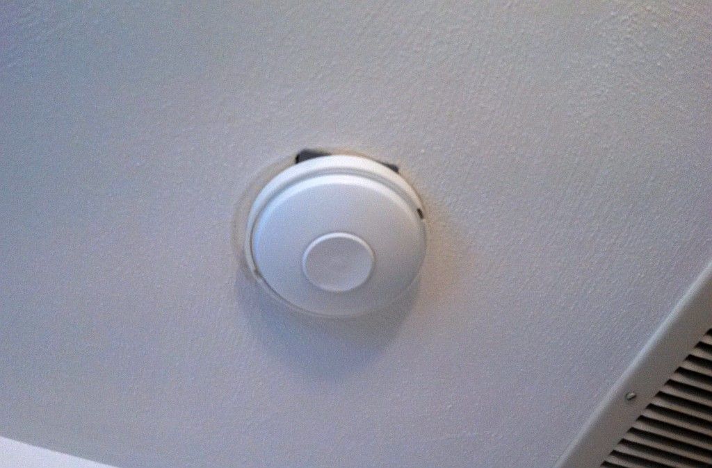

I've been tasked with performing our regular fire alarm test.
I've never done this before other than an initial test to determine/confirm that everything is working. For that I've used a can of aerosol smoke in front of individual sensors, however that seems like a bad idea to do on a regular basis.
Is there a standard routine for monthly/quarterly/annual testing? The Powers That Be would like monthly.
We have:
-a Notifier SGL-2000 2 zone panel
-2 zones, the lowest floor is (1) and the top 2 floors are (2)
-3 buzzers, one on each floor
-7 small sensors, one in each bathroom and one in the panel/mechanical room
-2 medium size sensors, one in each stairwell
-8 large sensors in hallways and common areas
When I started work in this building, the system was defunct. I replaced a bad sensor (small one in a bathroom) added a resistor were a sensor had been removed (there were originally two small sensors in the panel room) and tested it with smoke. I also cut power to the panel and tested the battery backup. Everything functions properly at the moment.

Small:
Medium:
Large:
The size of the detectors isn't really a factor. You need to determine if they are heat detectors and which type......fixed temp or rate of rise, or smoke detectors and which type of smoke detectors they are.....ionization or photoelectric. Each has it's own testing requirement with Notifier equipment.
Follow Hackworks advice and make sure your insurance covers you and that you are licensed to test and certify life safety systems in your area. After that...contact a local Notifier rep and they can usually hook you up with all the fun stuff you need to test each device.

Discussion Starter · #12 ·
Are you quilified to do this in your area?
Anyway here is a form you can use.
http://www.marysvilleohio.org/DocumentCenter/Home/View/140
Per my understanding, this is for our own internal purposes.
It appears that the panel was installed in 2002 but many if not all of the sensors are much older. Zone 1 was rewired either slightly before or after the new panel. If the sensors are much older, I'm wondering how much Notifier would still be able to help.
Looking at NFPA 72 and our local municipality's instructions, it appears that monthly test can consist of a visual inspection of the LEDs on the panel and on the sensors. A smoke test is only required annually, which was done within the past couple months.
Thank you BBQ for the form (and everyone else for their posts, of course)
