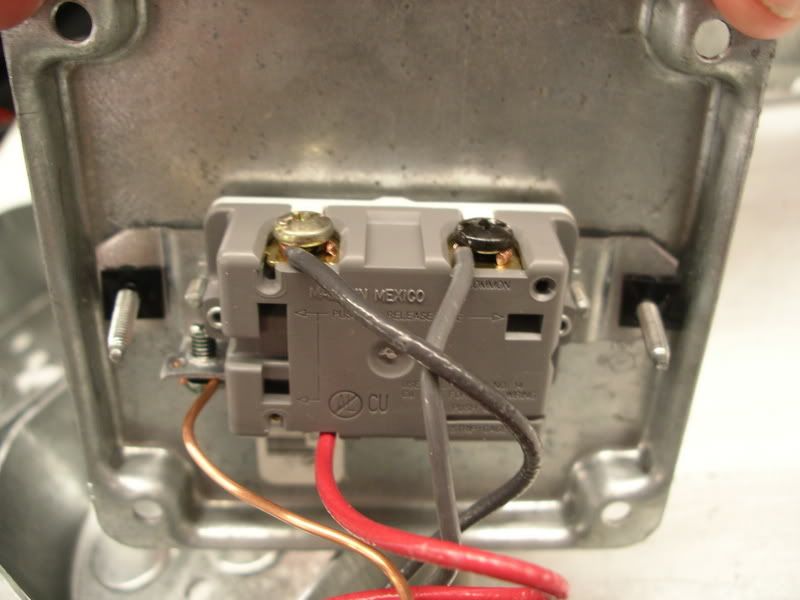

This is some of my own work here.
I was taught how to do this by a very skilled electrician.
The criteria:
No insulation under the screw
No bare wire past the body of the device
Wire traveling in a clockwise manner
Wire completely under the screw

Hey man that looks good. Criteria is the same we follow. We also add to that to wrap the device with scotch 33. Stinks if you missfold the ground when putting the device in and *POW*!
Good job. :thumbsup: What year apprentice are you?
By the way, that's an awesome close-up pic. How'd you manage that? Every time I try to take a close up pic with my HP 5megapixel cam, it's blurry. It's almost like the camera can't focus on close up shots. Got any tips?
not even 1st year yet:thumbup:
and the camera is designed for close up pictures
