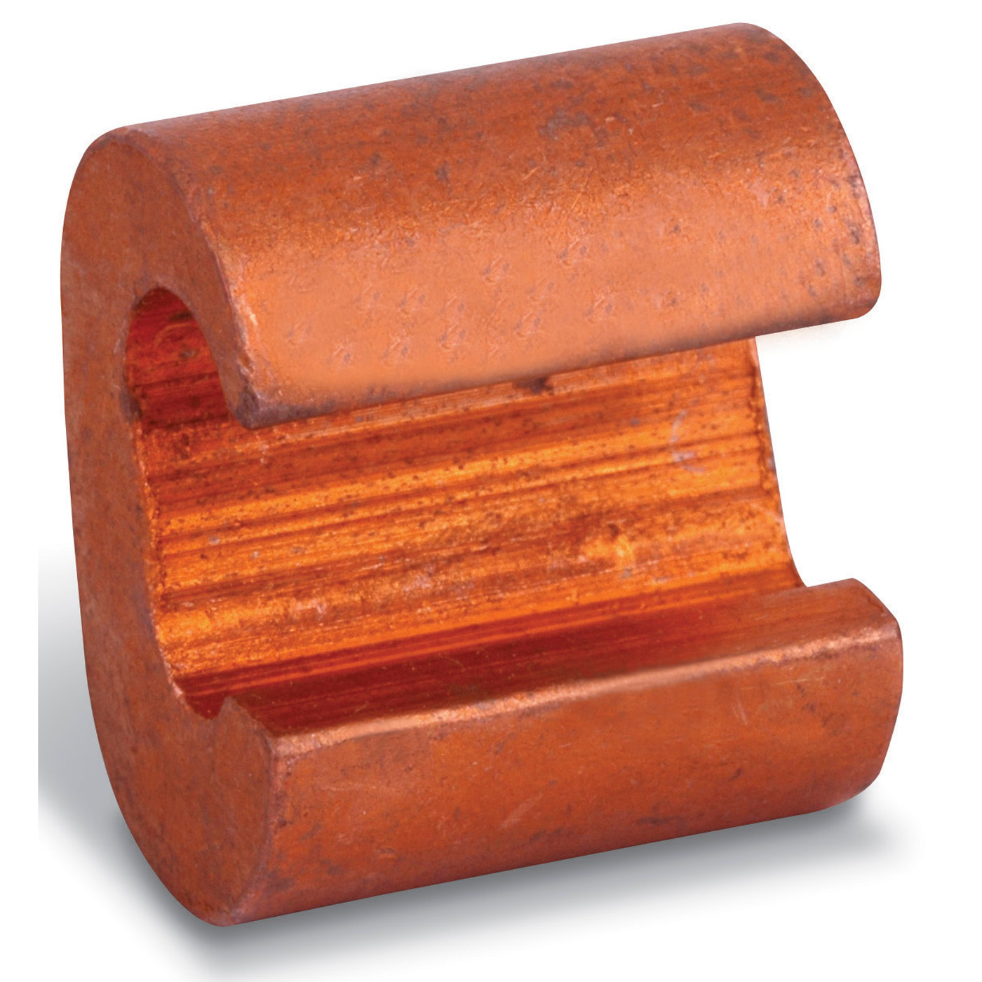

I splice them with a crimp a lot. Take a situation where the GEC is sized correctly when I do a panel change, but it only has one rod. I set another rod and crimp a wire to the original GEC.
Not saying you cant but in a new install its easier to just avoid it as much as you can. Kind of like splices in a panel.
And not all crimps are rated as irreversible, correct? Ive always thought all were rated like that but I don't know.

I use these.
  • E-Z-Ground® connectors are designed for direct burial and offer a safe, efficient alternative to exothermic welding products.
http://www.tnb.com/ps/fulltilt/index.cgi?part=BC202
