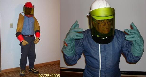

How imporrtant is the right PPE to you? Do you use PPE? Under what circumstances do you know you're supposed to use personal protective equipment, but you choose not to? Under what circumstances do you always use personal protective equipment?
The following picture shows rubber insulated PPE in the left pic, and arc flash PPE in the right picture.
Right hand photo courtesy of Joe Tedesco, NEC consultant, www.joetedesco.org.

That is some really nice metal on that there buckle.
Humm. What rating is on that buckle?:no: LOL

We have the rubber insulated gloves but have not had a need for the shoulders. We also have not had the need for Mr. Tedesco's set up. I have been looking into the ARC flash suits a bit. I hope they all dont look like footie PJ's with oven mits though.:laughing:

Eh, I was just showing off some of the gear. Not doing any work. I had pens in my pocket, too. :eek:
In my photo above, the black rubber gloves are by White Rubber, the leather glove protectors are by Kunz, the sleeves are by Salisbury, and the overshoes are by Servus. I forget who's shield that is. I'm pretty sure it's clipped into a regular MSA hard hat. The above manufacturer's are some of the main one's for such gear. Here's a tip... sometimes the local POCO will test your gloves and sleeves for you for free if you're an electrician. Saves you 20 bucks a year in testing.
The stuff I'm wearing in the pic is just di-electric, and doesn't help in an arc flash. Well, the face shield will. Otherwise, you'd just have melted rubber all over yourself. The stuff Joe's wearing on the right that looks like quilted coveralls is genunie high-dollar arc-flash gear.
