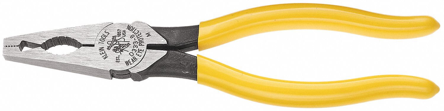

What do you guys use for tighten lock nuts. I have the one from channel lock or the good ol punch and hammer.

Insert the connector about 90 degrees from the position you want it to be in. Thread the locknut on and tighten it down as far as you can. Turn the connector with your hand until it's in the right position. It should be nice and tight and where you need it to be.

tighten by hand till about 1/4 from where you want it to be , then turn with channel locks to where its tight and should be, looking at you! to where the screw is looking at you!
