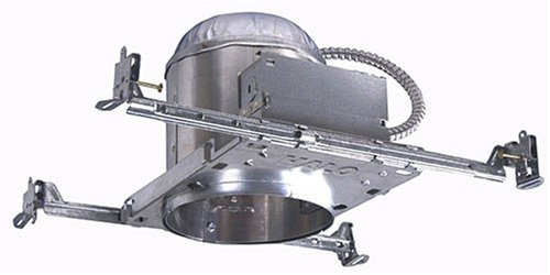

Need a can that can....
2049 34
Make down through 3 layers of 1/2" (2 sheetrock, 1 soundboard) ....:001_huh:
not sure if it's even made?

I can't remember how much adjustment the Halo's have. Set flush, you are through the first layer. I believe you have enough adjustment at that point to get through the second. Whether you get a full 1 inch adjustment, I'm not sure. Have to look at the website.

Halos have an inch or so leeway but 3 G lighting out of Canada is the only company I know that will make them however you want. We just ordered 50+ fixtures from there-- LED. double and single headed, trimless trims and we paid about $50,000.
I am sure the non led and single cans without the trimless design are much cheaper. Not sure if they will only make 1 or 2 cans...
http://www.3glighting.com/ you must order with the extended throat

We needed to come down about 2.5" because they were using Baswaphon on thye ceiling as a sound deadener. This stuff has caused many issues.
For 1 1/2" I think you could use the halo and get real close. Use a 30 wat trim and it will fill the small gap that is left

You could also lower the entire can and they can cut the sheetrock around the can on the first layer

H7ICTNB. Same thing as a regular 6" can, but without the bracket for the socket. You use a trim that the socket snaps into, i.e. HAL 30WAT.
That is all we use-- H7ICTNB with a Halo 30 WAT or a regressed eyeball.
