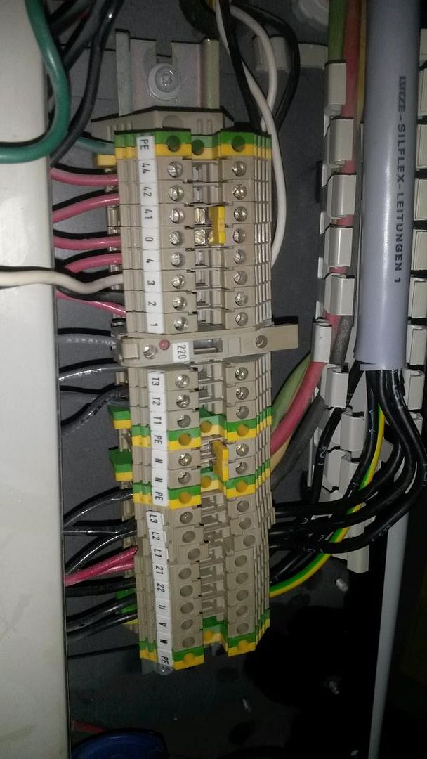

Motor is wired for 3phase 250volt. Customer would like it to work on single phase.
The motor label configuration looks like what I got looking at the motor wiring, so this leads me to believe I could change something in that terminal block instead? I dunno, I'm at a loss here. :001_huh:
3,670 Posts
Sell him a 3 phase service.
Maybe some kind of single phase to three phase converter but I don't know how those work or if they are any good.

so the wiring config is for 3 phase 240v and 3phase 480...sh*t.
3,670 Posts
Yeah, plus it looks like it is only one component of a system? - Your 3rd. pic.

The terminal block sends all those wires to a contactor and on/off, forward/reverse switches...it's an industrial paper shredder.

You can't enter change 3 phase and single phase.But that three phase motor(in the picture) is dual voltage you'll have to look at the motor specs to see if motor voltages falls into the voltages you have in your building electrical system .you speak german? Lol
Perhaps a buck boost transformer if you have the correct system will give you the correct voltage for the motor.
Some of the other guys know more about this stuff than I do ,I used to rewind motors but I've forgotten a lot.:(:laughing::laughing:

Sell him a phase converter. Install a single phase fed inverter on the 3 phase loads or replace the motors with single phase ones. Those are your only options.

jeebus, after a quick search I found static, cnc phase, rotary...sheesh.

If it is just one small motor an inverter might be the best option.

Are you saying one leg of single phase, or two legs?
Maybe I am missing something. Plus, why would the customer want to?
I worked on a single phase motor for a shredder, and the forwards and reverse controls for 3 phase are already in place with interlocks. You have to know what you are doing to replace with a single phase that has the same controls.
And with a Vfd, you would have to control this to the Vfd and not the motor (I think)

oh damn it that would have to get rewired as well?:blink:
