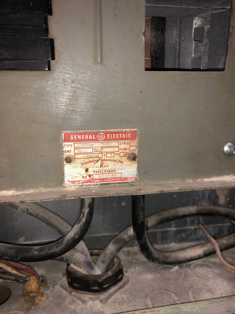

I'm in Panama, my house was build by the US Army, this used to be Ft. Clayton Army base.
My panel and breakers are very old and can't find replacements in the local market. It is even difficult to find them on eBay and the few ones are very expensive.
The panel and breakers are General Electric. The panel has a metal label that says:
General Electric
Type: NLAB Style: 2
AMP: 225 Plant: P
120/240 V: 1 PH: 3
PANELBOARD NO. 929579
Plainville, CONN, MADE IN USA
And the rest is mostly unreadable

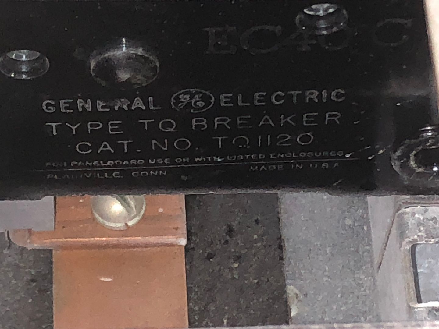

A 2 pole 20 Amp breaker says:
General Electric
Type TQ BREAKER
CAT. NO. TQ1120
I can find breakers with model TQ1120, but they are different, so I don't understand how they can be the same model and not be compatible.

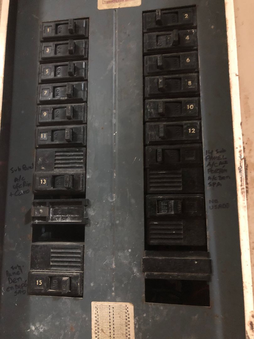

The breakers have some "legs" or bars and must be screwed to the panel. They are not like moderns breakers that just plug into the panel.
I'm attaching some pictures.
I would like to buy replacement breakers, as some of them are starting to have issues. I would like to avoid replacing the entire panel unless that is the only or best way to go.

I'm finding them at $119 for a 2 pole 50 amp breaker, which seems used. I wonder if there is a way to adapt a more modern breaker to my panel. Are newer bolt-on breakers compatible and perhaps I can reuse the "legs" from my old breakers?

Eaton Cutler Hammer makes replacement inserts and covers that will replace the the guts without removing the can, but all dimensions need to be taken, width, depth, height, type of cover, flush or surface and a list of breakers, for them to manufacture a replacement. You end up with more common easier to get, less expensive breakers. If those that you have are obsolete and no longer manufactured, used or new surplus are likely available, but as others mentioned, may cost more than a new panel (though maybe not, depending upon labor).

Thanks to all for your replies. I think that the panel enclosure is so large, that it may be easier than thought to place an entire new modern panel inside, or just the guts of a modern panel. It may be a tedious job, but with organization, proper labeling of the wires, etc..., it may not be that hard after all. I will ask an electrician to quote it.
