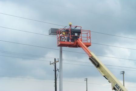

The following picture shows men installing parking lot lighting from a JLG boom lift. Special thanks to Derek Pasch, Staffing Specialist at Meisner Electric in Delray Beach, FL for the pictures. The fella on the left must have been on break. He appears to be asleep. :jester:
617 Posts
Or perhaps just scared of heights and trying not to puke.
Were they raising the poles with the snorkel lift or just attaching heads?
We did them from a JLG once, but they wre on wood poles, normally we mount the heads on the ground and have a crane out for a couple hours to raise all the poles.
Were they raising the poles with the snorkel lift or just attaching heads?.
Hard to tell.
I always bolt the heads on while on the ground, and go ahead and run the conductors down to the handhole and get everything wired up at the heads. That way, all you gotta do is stand them up and get them level. Myself, I generally get them all stood up and "eyeball level", then go back and fine tune level them all at once. Sometimes you need to tape a nickel to the end of your level to compensate for tapered posts. I know people have lots of different tricks for leveling tapered posts. Some guys hang a plumb bob at arm's length, and stand back and sight the post off that hanging plumb bob.
617 Posts
We always hang them as fast as possible too, with crane costs and all. Last summer me and a JW I'm used to did 26 in less than 2 hours, we were pretty proud of ourselves. Then he leveled for the rest of the day while I wired (and fought wasps in one pole, I batted down at least 4 with a shovel I found).
I like that trick of taping a shim/nickel to the level. Once you get it set then all the poles will be the same.

What we generally do (this is our 3rd Lowe's this year, and have done a few other styles of lights in the past) is level the lugs first on the concrete pads. Then just stand up the built pole with either the boom truck or rent a crane and set them on, and then all you have to do is burndy the leads together. Most of the lights we do are either 277 or 480, 2awg to the base, 4awg from the base to the heads. Longest pull for the parking lot lights was 760' of 4awg, that one took a while with the old tugger just a tuggin.
Before we stand them up, we heat 'em up :thumbsup:
If the bulb, ballast, etc turns out to NFG - it's a quick swap on terra firma :thumbup:
