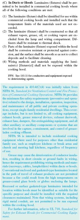

This is a commercial kitchen in a town that has tight ass electrical inspectors and I want to make sure. The hood did have the (mason jar) vapor tight light fixtures with guards and with RMC running inside the hood. I did assume that this was the standard way of installing them because I have installed them this way in the past. But shouldn't the RMC/IMC/EMT have been run on the outside of the hood because of NEC 410.4(C)(4)? Plus I cannot find a cut sheet stating that these fixtures can be used in the hood.
Yes, it would appear so. The handbook commentary seems to clear that up. I wonder when this section was added, anyhow? I see raceways for the lights in the hoods so regularly, I why I wonder. Thanks for bringing this up. It's interesting.

For those following along at home, here's the code text with the handbook commentary:
