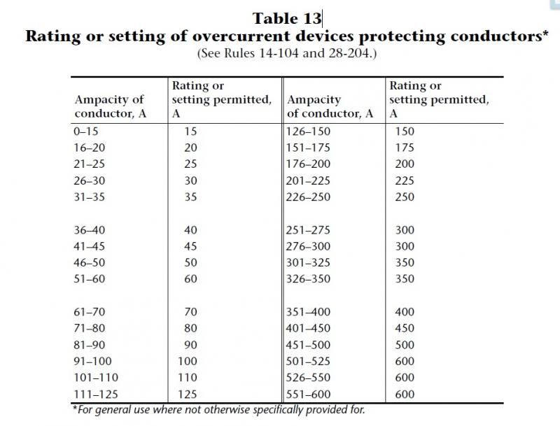

Part of Rule 14-104 of the Canadian electrical code states:
14-104 Rating of overcurrent devices
The rating of overcurrent protection shall not exceed
(a) 15 A for No. 14 AWG copper conductors
Part of it also states that:
The rating or setting of overcurrent devices shall not exceed the allowable ampacity of the conductors that they protect, except
(c) as provided for by other Rules of this Code.
Now I take (c) as provided for by other rules of this code that table 13 counts. If it does, then looking at table 13 it lists that if the ampacity of the conductor is between 16 and 20 amps that the rating or setting permitted can be 20 amps. Now looking at table 2 it lists 14 AWG at a temperature rating of 60 / 75 degrees that the allowable ampacity is 20 amps.
It seems to me that Rule 14-104 and Table 13 contradict one another.

No the rule of 15A applies, unless some other rule (after section 14) over rules it and allows a higher ampacity. That could be motors, generators, transformers, capacitors, heat...etc. In that case you could go to table 13 for information, but that table is useless in my opinion.
In short, you can't just ignore rule 14-104 and jump straight to table 13.

Table 2 refers you back to 14-104(2) for 14, 12 and 10 AWG. They changed these values to help us when derating, you still need to product the conductor as you always have.
And like Rollie said, table 13 is for motors.

You need to READ the code book, follow the references and appendices. Had you read appendix b, you would have seen this:
" Rule 14-104
Although Item (a) permits overcurrent devices larger than the conductor ampacity, they are restricted in rating or setting to the upper limits of Table 13. The conductor size should be determined and then Table 13 consulted only when an overcurrent device of the exact rating is not available. In other words, Table 13 is the last resort, although the use of time-delay fuses or fuses referred to in Rule 14-212(b) will assist in selecting a fuse of proper rating due to their availability in a greater range of values."
How much better written do you need it to be?

14-104 (1) (c) is the gateway for motors and heat.
14-104 (2) says except for specific rules that govern specific items, you follow these rules.
You really need to read the appendix B information. It is VERY clear on the role of table 13.
Table 13 is the "table of last resort". Every other section of code deals with OC devices for conductors in their section and I can almost guarantee that.
If you call for an inspection and tell the inspector when e asks why you ran #8 for a 60amp sub and quote table 13 he will laugh and tell you to change it.
If you include table 13 into your math for your install, your not doing your job right.
