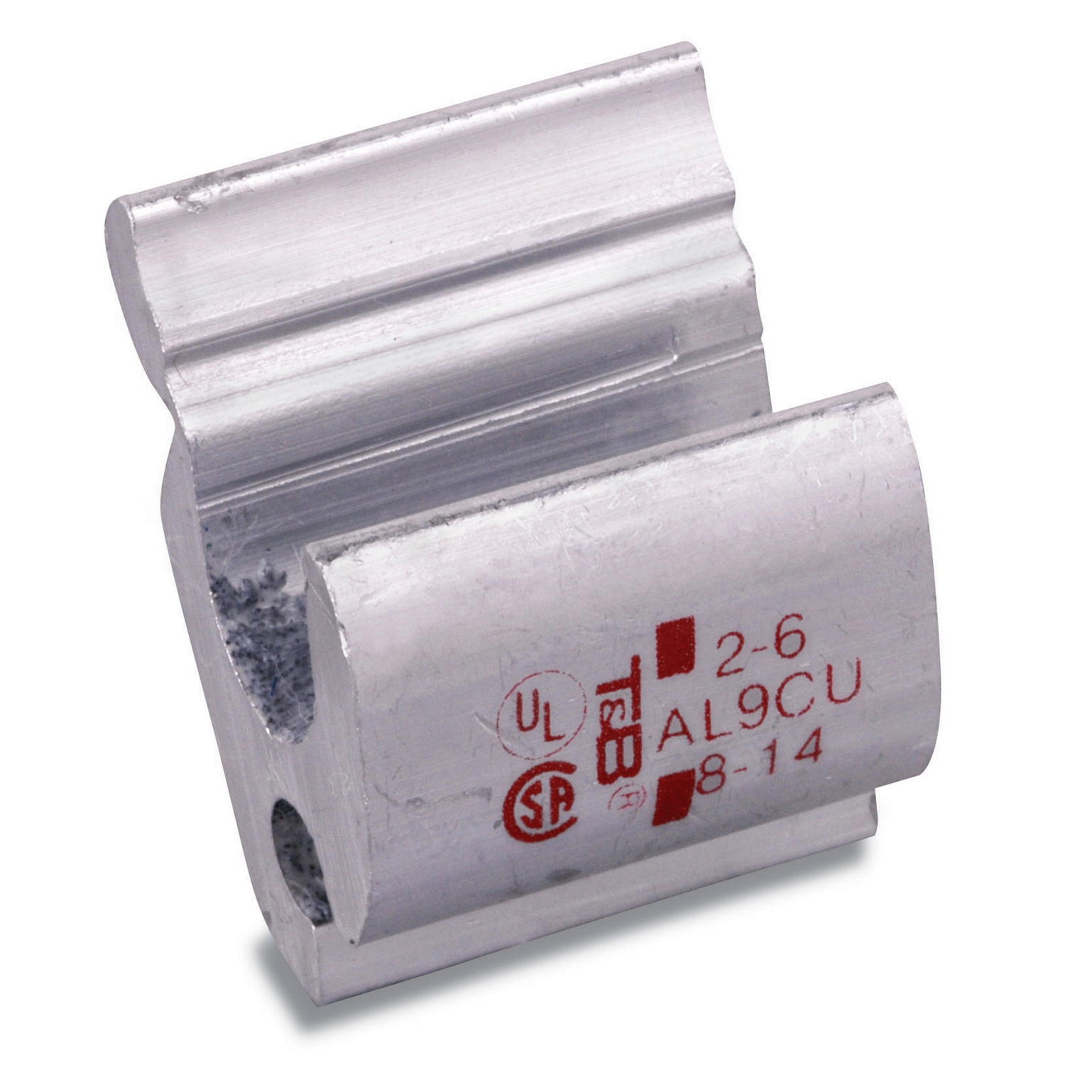

Who makes a split bolt type connector that would snap off when tight making the connection irreversible?

Why not use these?
Cheaper than split bolts :thumbup:
Sure looks like it to me.
2
more money than an H-Tap. shear bolt never comes in contact with voltage
*never posted my pic
Is that irreversible?
nope!
Once they are crimped they stay that way. Hydro here uses them all the time for the overhead connections.
You would need a crimp tool, usually borrowed from your SH or buy a Burndy MD6 crimper.
Why not use these?
True dat. Haven't used a split bolt for other than motors since we bought a crimper and 400 of those little darlings. :laughing:
The Blackburns are about 1.50 each plus plastic cover or part roll of tape
oh i know how much they are, i use them about 3 days a week. I just was showing those odd ball things for something different. All you need is an impact, socket and adapter, done.

what brand is that? The only ones I've seen are the coupling type which are not insulated.

you may have a point there, then again a grinder would dismantle an H-Tap pretty decently too
i'm not sure the brand i'd have to find one in my truck. I've never bought them. A hyrdo guy just gave me a mittful one day when i was doing an overhead service :thumbsup:

The inspectors let us crimp the GEC to extend if necessary.
Anything can be reversed if you put enough effort into it.
Sure, a crimp is irreversible, but it also requires a $300+ crimper and the correct die.
I'm talking about a connector that has a lug that breaks off so you only need basic tools for it. I believe that is what the OP is asking about as well.
I never understood this "Irreversible" hype. Technically, wire is the most reversible part of the installation.
Cadweld the POS. That's irreversible with out a grinder.
Supply houses around here have loaner tools.
Its worth looking into if anyone needs a specialty tool.
