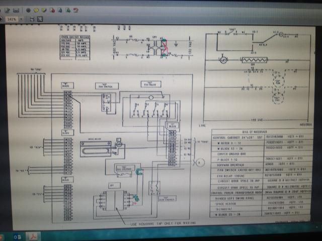

So if there is a single phase additive polarity XFMR which is wired as subtractive as per the attached drawing. I have asked an engineer and was told not to rewire the secondaries and leave it as is due to all the load being resistive. I was thinking it might short when it is energized, he disagreed. I redlined the drawing how it should be re-wired to have additive polarity so it matches the transformer and was told to leave it as is and energize. The drawing shows my mark ups, if the drawing had no mark ups do you think it would short?

Oh my apologies. No im not a student. I have been in a field for a few years now.
This problem kind of startled me since I thought it would be obvious to re-wire it and engineer disagreed with me. As the result, I found these forums to maybe seek an opinion on this simple yet confusing to me issue I guess.

Why would you think it would short out? Looks like you've just drawn a line to have the grounded leg on the other terminal.
That's correct, according to my mark up it would be perfectly match additive polarity of the transformer but the engineer asked me to delete my as-built and leave the drawing as is and energize without my mark ups or re-wiring

Which leg you ground will have no bearing on polarity

That's better, so if I left the drawing as is, without my mark ups and no re-wire, would the transformer short to ground upon energization?
Nothing from that drawing shows a reason for anything to short. You can always booby trap it to mess with the engineer though

I am curious why you think grounding x2-x4 is any different than grounding x1-x3? If both are bonded then yes there is a short. If one, then no, you just have a grounding reference for the secondary voltage. It's AC voltage, the AC doesn't care.
I'm also curious why you think you know more than the engineer when you say you've been in the field a few years
