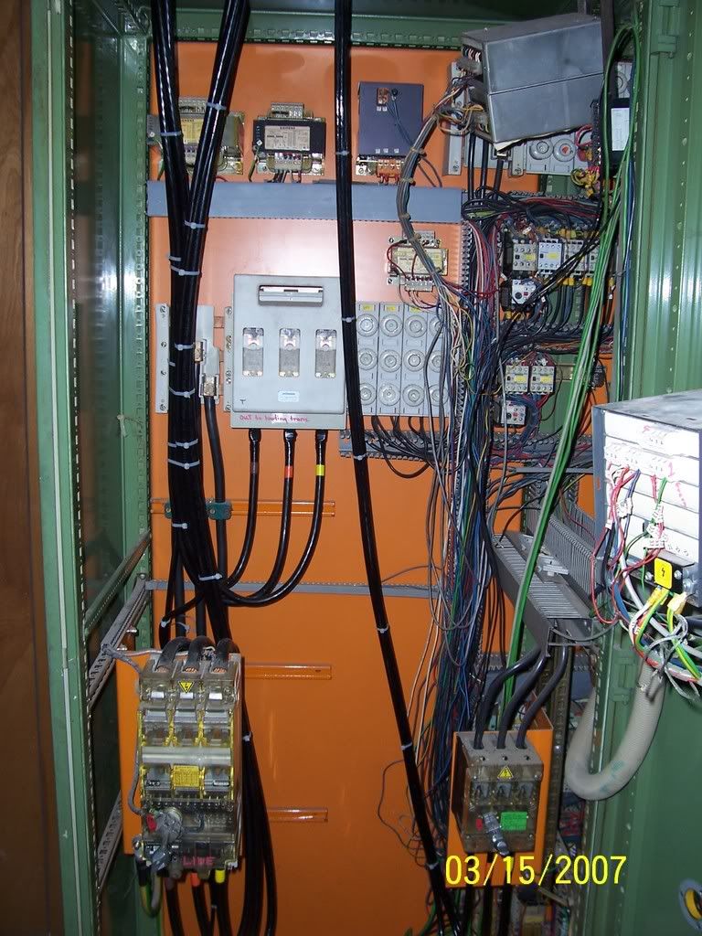

Here's the breakdown on what I know.
The shunt trip will kick out if there is a temperature overload on the furnace, that way it will shut off everything leaving the control cabinet.
You can see the shunt trip 200A on the right bottom of this picture.
I'm feeding three phase for a secondary power because that's what was originally hooked to it at it's old location and not a cop-out, but that's what I was told to do. Perhaps to save power in my opinion due to the 630A it gets stepped up to comming off the load side of the xfmr.
why aren't the '2' neutrals tied together to make one neutral?
Joe I'd say this is the case, though I'm not 100% sure, I was just paying attention to the load side of the xfmr which has two 'hots' and two neutral lugs. One of each feeding each side of the furnace's elements.
In this picture you can see the transformer in the lower left corner with two 2 1/2" conduits leaving. One conduit feeds left side and the other feeds right side of furnace. Each "hot run" if ran through a 630A fuse.
This picture shows where the hot and neutrals come into the furnace, keep in mind each side got 3 3/0's parrallelled for the 'hots' and 3 3/0's parrellelled for the neutral.

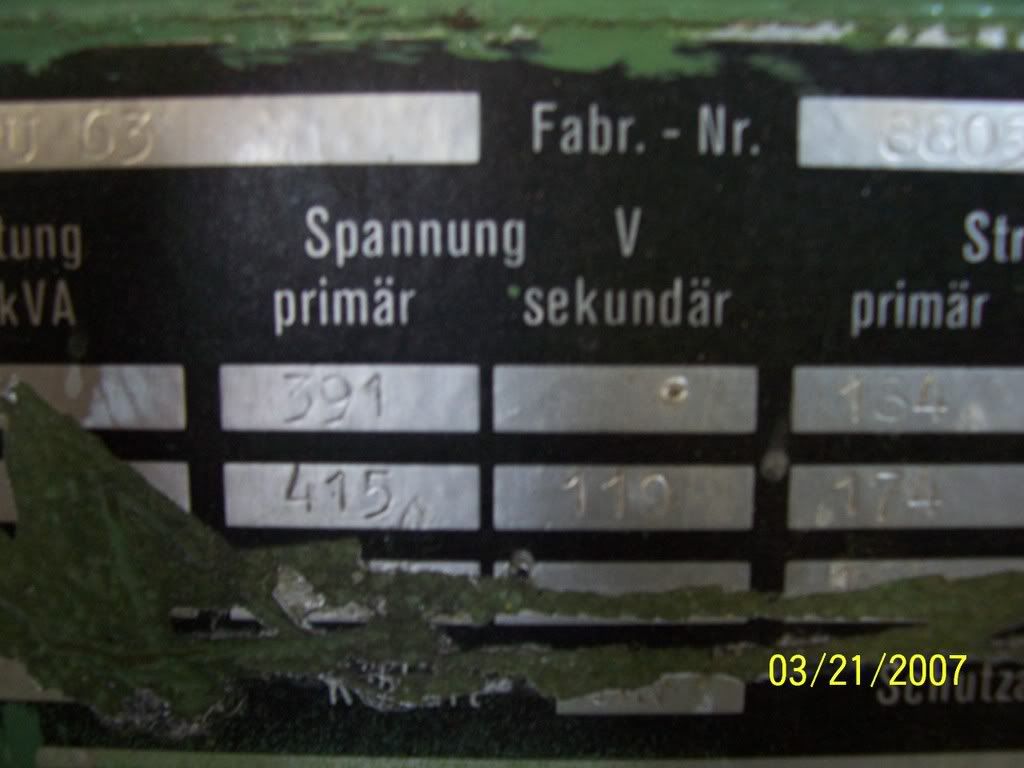

I took a picture of the coverplate for the transformer, it's hard to read though in the pic. So I'll rewrite the values for the fields below the pictures.
KVA = 70
Primar V = 415
Sekundar V = 110
Primar A = 174
Sekundar A = 637
Typ(in upper left corner) = PTU 63
Fabr-Nr 880526
Frequenz = 60 HZ
Betrieb = LB
Schaltgr = I10
Isol.Kl. = T40E
Kuhlart = AN
Schutzart = IP 23

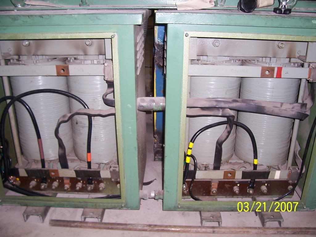

Here's an overall side shot of the transformer. It is fed from the left, the load comes out of the right side.
Below is a close up of the left side of the transformer.
Below is a close up of the right side of the transformer.
More images in next post.
5
This shot is a bit closer up on the entire side.
This is an upclose shot of the load side (110V w/neutrals). The fuses have been removed so we could check the secondary voltage without it going to the furnace.
This is the same as above, just a bit further back.
And there you have it!
The ground comes in the left, lands in a terminal on the leftside, had two comming out of that one to a lug to the cabinet and one continuing to the ground lug on the right side of the transformer. Had two comming out of the right side ground lug to another cabinet lug we put on for the right side and to the ground bar on the load side.
After we took the ground off of the cabinet lug the breaker set. It would 'ohm beep' from that bar you see on the tops of the transformers to the cabinet. It would also 'ohm beep' from ground to neutral on the load side.

KVA = 70
Primar V = 415
Sekundar V = 110
Primar A = 174
Sekundar A = 637
Fabr-Nr 880526
Frequenz = 60 HZ
Betrieb = LB
Schaltgr = I10
Isol.Kl. = T40E
Kuhlart = AN
Schutzart = IP 23
For this listing it kinda spook me a bit :eek:
and i dont know if you mention the spec are set for single phase ?? i was going thru the figures twice and are you running the transformer set up in open delta or close delta ?? it do make the diffrence there
I hope you relized that you are actally overdriven the transformer ??
i did read the primay voltage from name plate it say 415 v ,, ok that common in European area system .
secondary side it say 115 volt ok if that feed for furance heating elements
but this transformer is calberated at 60 HZ as i did read it now
and look at one of the photo at the section #11 i did see two fuse holder there and one look bent or overheated
i don't know if you did read the primary amparage with ampmeter ? it should stay near the max primary amparage
but one thing when you increase the voltage on the transformer the amparage will drop but a catch if you have electric heating element the current will go up with voltage as well
Merci , Marc
