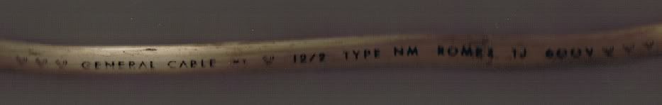

It's pretty common to run across old braided jacket NM cable without a ground. It's very rare, in my experience, to run across NM cable with a thermoplastic jacket that doesn't have a ground wire of any sort. Often, you'll find the plastic jacketed NM cable with a reduced size ground. Very seldom do you run across plastic jacketed Romex without a ground, but I did today. Just a piece of paper interleaving, tightly wound, where the ground would normally be. No ground inside that brown paper at all... just a twisted rope of paper. I saved a big piece, and took some pictures and scanned in the jacket labeling. I wonder what years this stuff was used? I would have to think that it was just a very few years.

I have seen a lot of 14-2 with a #16 ground. Never seen 14-2 or 12-2 theromoplastic without a ground.

I almost never see it, which is why I thought I'd better snatch this sample. It was a kitchen remodel, and most of the existing wiring was either K&T or braided romex. All that got torn out, and I was planning on re-routing this one run of plastic jacket NM to the new frige location when I noticed it didn't happen to have a ground. Darn. Tore out maybe 25' of it. I'll probably save it for a conversation piece.

Never seen armored SE cable, thank God. I wonder if that wire you found today was a factory screw-up?
No, I've seen it a few times before. A very few times, which is why I took pictures this time. Hillbilly says he's seen a lot of it down his way, so maybe it was more regional? Might have to do with what codes were enforced when and in what area. Hard to say.

I cut out a bunch of it today at a remodel/ addition I am doing. This type also has a solid plastic thread running inside between the black and white conductors, sort of like a strength adder. But no equipment ground (bonding) conductor.

Last week a contractor brought in a piece of 14/3 about 25 feet long. It is new NM cable without an equipment ground conductor... I was thinking it is a manufacturering mistake...I kept it for the classroom display
