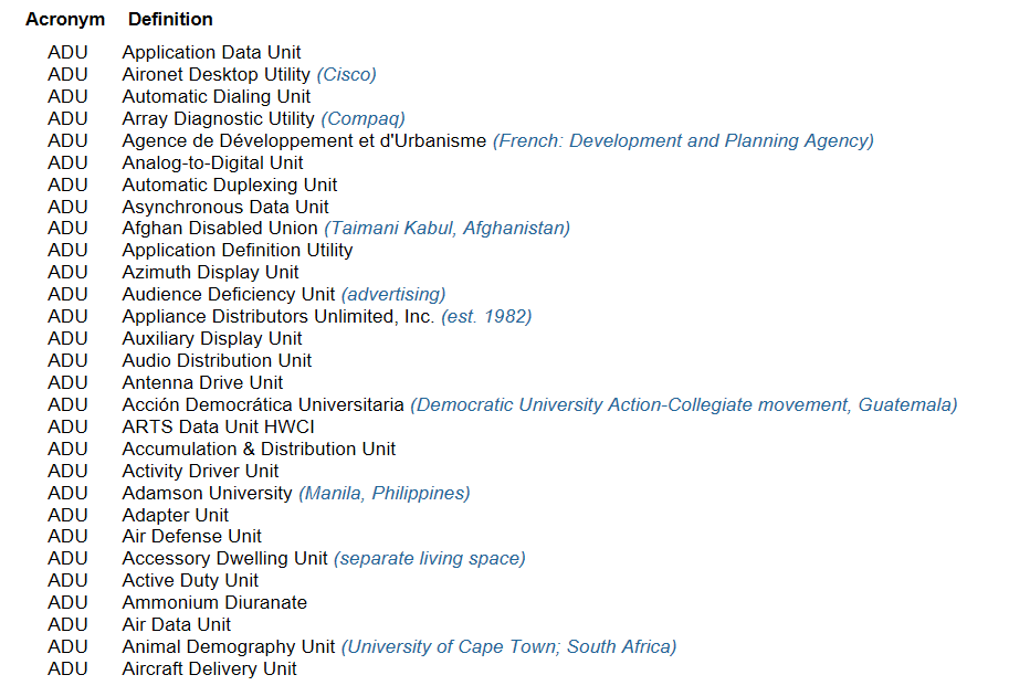

Type ADU into the google bar and see what comes up first.
Well, I did just that very thing....and here is what I got. Perhaps if people wouldn't type like they are texting, these misunderstandings wouldn't occur.
Reactions: 2
CopperSlave said:
Well, I did just that very thing....and here is what I got. Perhaps if people wouldn't type like they are texting, these misunderstandings wouldn't occur. http://s357.photobucket.com/user/treeyasoon/media/ADU_zpse7487745.png.html
