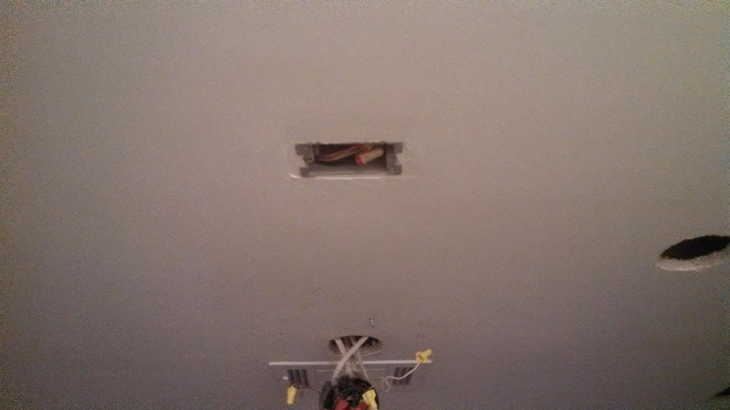

Went to fix some electrical issues at a job today the HO wouldn't allow the original EC back to
One of the issues was a downstairs bathroom GFCI not working
Tracing out the circuit we found a wire that was never reconnected so we had to find somewhere to junction the wiring in the ceiling
They had a wireless sensor in the ceiling so we cut a jbox in and installed the sensor back on a blank cover
