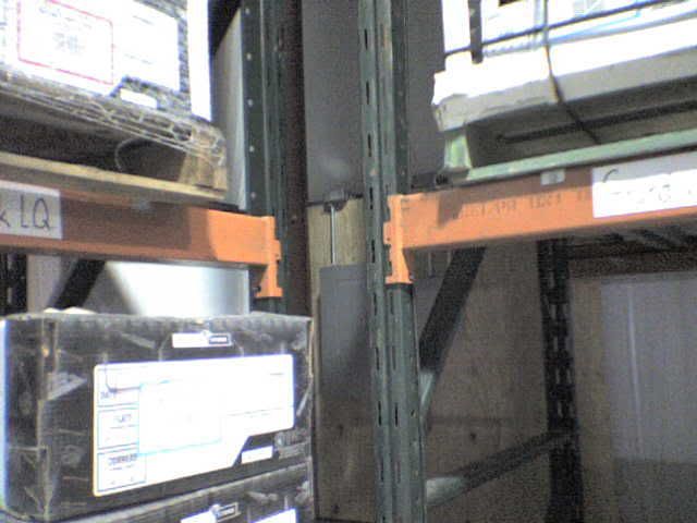

I went to finish up a little work in a small warehouse space I wired a couple of months ago. I warned them that I needed at least a 3 foot square in front of the panel. Well, when they erected the racking, they gave me a 4 foot square in front of the panel. I just can't get into it. This might be legal. I havn't looked into it much yet.

Welcome to my world MD. In industry we fight for all the room we are required. It seems most of the production end thinks that 3 ft for the electrician is wasted. A few subtle reminders are sometimes required. Like the time I found baskets of parts sitting against a panel door,they wound up setting against the production leaders desk! I swear I don't know how they got there!!! But never had problems in that aea after that.

We do work in a place that's starved for space. Our service guy, a grumpy old man, told them they need to keep the panels clear, so these people got a painter to paint yellow caution lines on the floor no wider than the panels and no deeper than 14 inches.

Looks like you came to my place and snapped that pic. I have signs and the floor is painted, but I have realized that people are blind, and/or can't read.
MD read the rules for egress. The pics show a violation.
Cool, thanks. I just didn't really put any effort into looking it up. Thought the picture would make for interesting discussion. You're absolutely right, though. Here we go:
110.33 Entrance and Access to Work Space.
