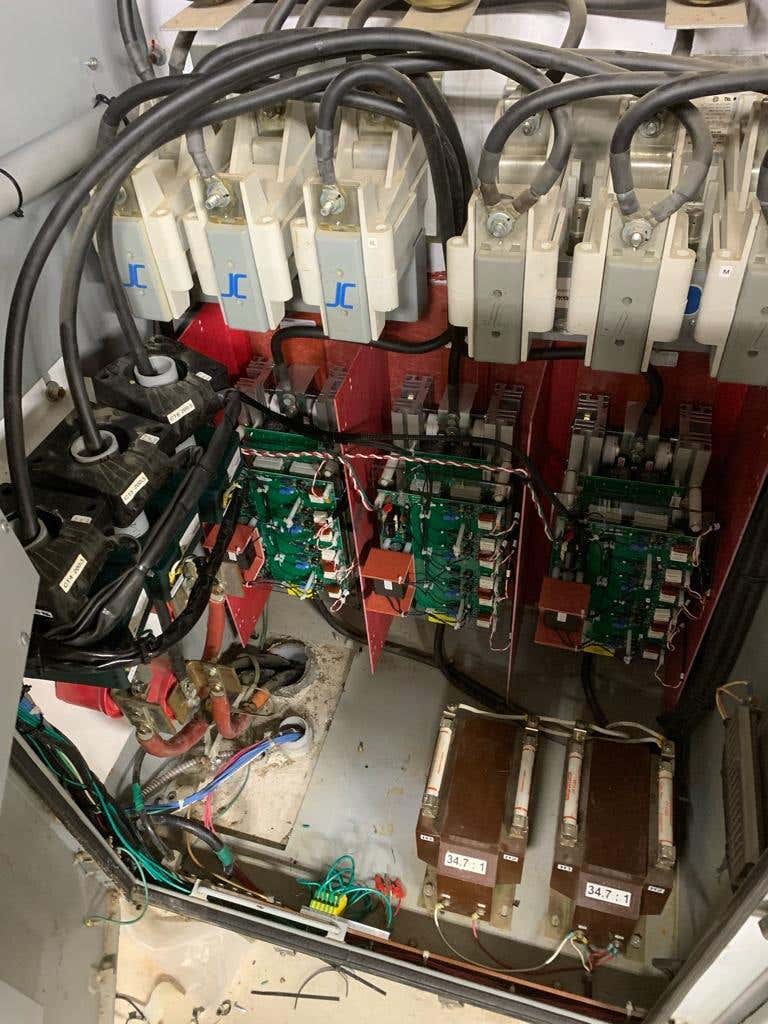

Retrofit. The original had problems like taking a dunk a couple times. The firing boards were no longer repairable (too old to get parts). The old firing boards were in the controls instead of the current design that runs plastic fiber to the control board. The phase stacks and half the CTs and controls (not shown) are all new. The contactors and PTs are original, I tried to clean up as much of the customer wiring as possible. Not a fan of the power wire routing but that’s factory original and seems to be holding up with no signs of corona damage and I was on a time limit getting this thing operational.

The old one was a Benshaw Micro. The new one is the Benshaw MVRXE. If you are familiar with the product the big changes other than newer parts is that the phase stacks communicate with fiber instead of electrical wiring which is very common among all MV brands these days. The main board is essentially a modified MX3. Much more compact. They supplied it with the entire control panel and the entire phase stacks prebuilt with some extra long glastic strips so that the phase stacks bolted to the original studs. We didn’t have to drill a single new hole for anything. Everything came in a big kit. It came with prewired cabling, fiber, plenty of cable loom. The only thing we supplied other than labor was a lot of tie wraps. The instructions were the standard manuals and two sets of prints, the final one and one with a lot of “cloud” markings showing most of the changes. There were a lot of controls changes. The MVRXE and Micro are twenty years apart. Much of the controls was simply completely different. But at the end of the day after adjusting some programming on the relays and replacing one bad cable (our fault) it just worked exactly like the original.
I do recall now dealing with a single Toshiba MV soft starter. It was a private labeled Motortronics but in a very unique and frankly terrible layout. All contactors were Toshiba which is fine. But it had the controls in the middle of the cabinet and at least one contactor including the incoming wiring was buried in an inaccessible area behind it. It was decently built but extremely maintenance unfriendly. When the firing cards developed an issue Toshiba played clueless and Motortronics was pretty much avoiding it like the plague. We ended up tearing out the whole thing and replacing it because it kept blowing out the utility fuses on the primary side of their transformer and was turning into a money pit. We were stuck replacing all 3 phase stacks at which point the water plant just wanted to replace it all with something reliable.
