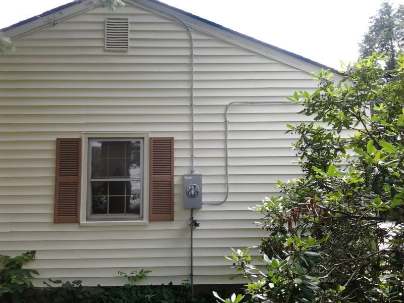

Friday's work.
Let the SE cable is hack,:cry:slam-fest begin.......:whistling2:

It looks like a CT service change with the meter hanging and the socket jumped.
The last one I did was in Waterbury.
When I went to the city hall to pull the permit, the inspector gave me jumpers and a cover and told me to pull the meter but not plug it back in.
We have to do the cut and reconnect but not plug in the meter.
CL&P wants to plug it back in.
I guess a jumpered meter socket and free electricity is ok with CL&P until they get around to reinstalling the meter.
Sometimes they will redo the drop connection.

CTshockhazard said:
The saga is that many here think SE cable on the side of a building is unsafe and hack. Feed in the top, then out the side of meter.
No, meter was on the back of the house which is no longer permitted by POCO regulations, front or side only.
Basically it is done because most service changes go from ringed to ringless meters and the two are not compatible with the other's can.
No free power at all, CL&P does "estimated" billing during jumper period.
Thanks, you may spend your money updating someone elses property as you see fit. Me, :no:.

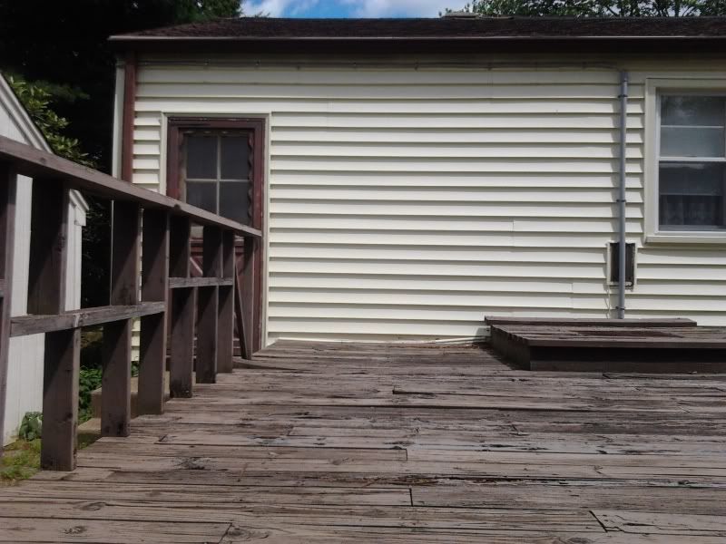

No meter above a deck also I would think

I see nothing wrong at all with this install..some of y'all need to get a grip. :laughing:
It is neat, compliant and I presume passed inspection. It was sleeved at the deck so the protection is there.
Then again, there are those here who think rigid service risers in the wall (which is and has been a standard in California for over 60+ years) are deathtraps. :rolleyes:

#30 ·
That is only because it is not something you see everyday..
There are more than a million houses here on Long Island that have SE electric services.. just another POCO approved wiring method..
Almost all houses had SE cable until PVC became the latest craze..
#29 ·
It has an overall outer jacket... :whistling2:
230.9 Clearances on Buildings. Service conductors and
final spans shall comply with 230.9(A), (B), and (C).
(A) Clearances.
Service conductors installed as open conductors
or multiconductor cable without an overall outer
jacket shall have a clearance of not less than 900 mm (3 ft)
from windows that are designed to be opened, doors,
porches, balconies, ladders, stairs, fire escapes, or similar
locations.
Exception: Conductors run above the top level of a window
shall be permitted to be less than the 900-mm (3-ft)
requirement.
